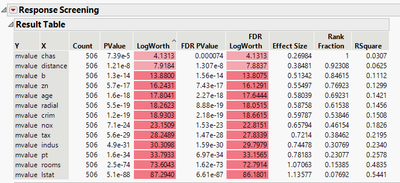

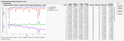

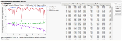

2. The other thing I'd like to do is set several of the columns to be "sortable". What I mean by this is to give the column in the report table box (above screenshot) the little carat "^" or "˅" so the user can sort the report table box by a column of their choosing. This option is available in the XGBoost platform, see screenshot below, where the Train RSquare column has a "˅" next to it. The Response Screening platform also has this capability, see last screenshot.

Hi, You can send the table box a <<set click sort message, as below. At first, you will not see the "sort" carat icon, as you've got to click on a column header first. Then, clicking will cycle among ascending sort, descending sort, and original order.
