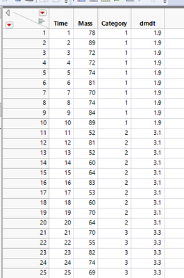

I would add two formula columns:
  1. First to calculate category
  2. Second to calculate dM/dt
Then I would create Summary table and report that.
Start table:
End result:
Here is example script with two calculations for categories and ending up with summary table, this all can also be done interactively from JMP:

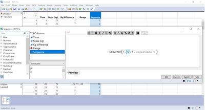

Hi @haleyhoewt ,
in the following table you have a script that will produce the table summary.
you can change the size of the ranges by modifying one number in the sequence column as in the picture,
let us know if it helps

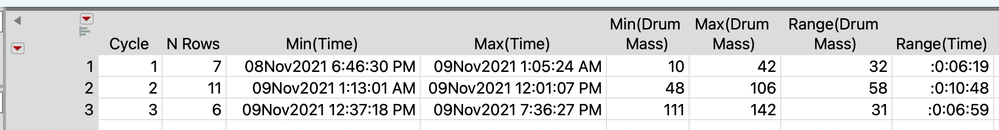

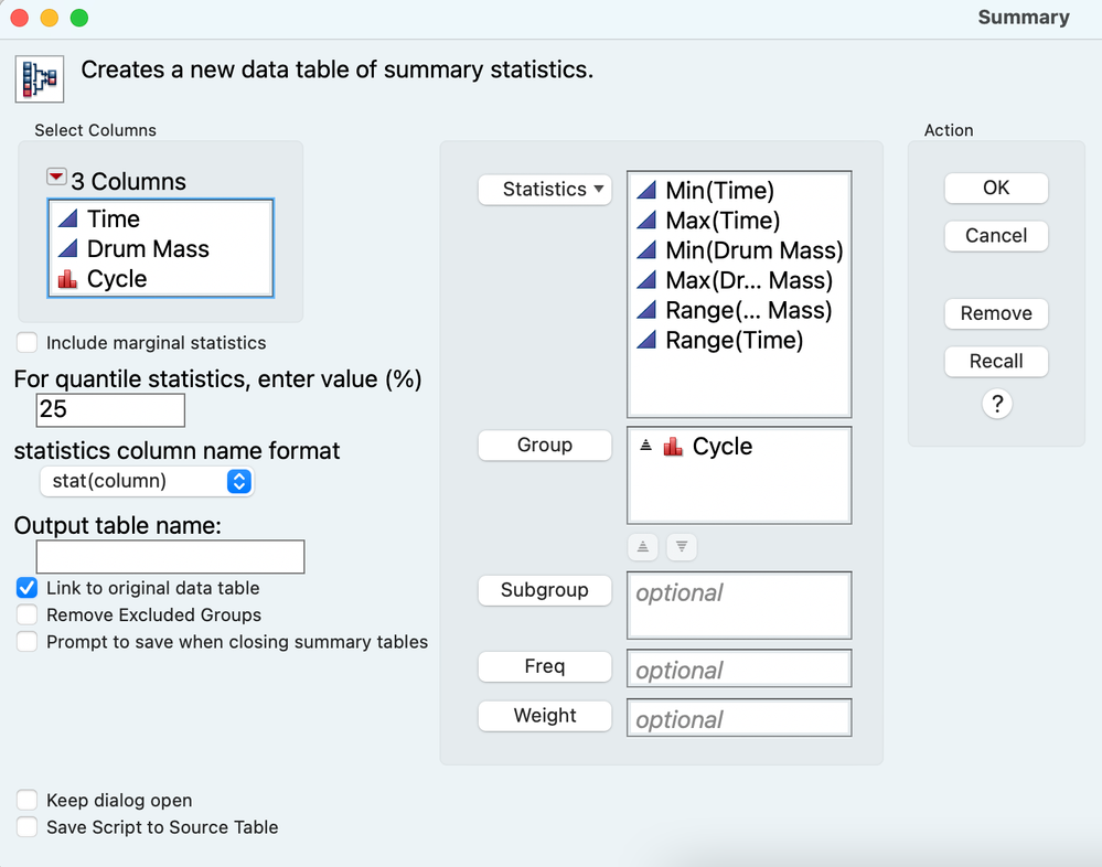

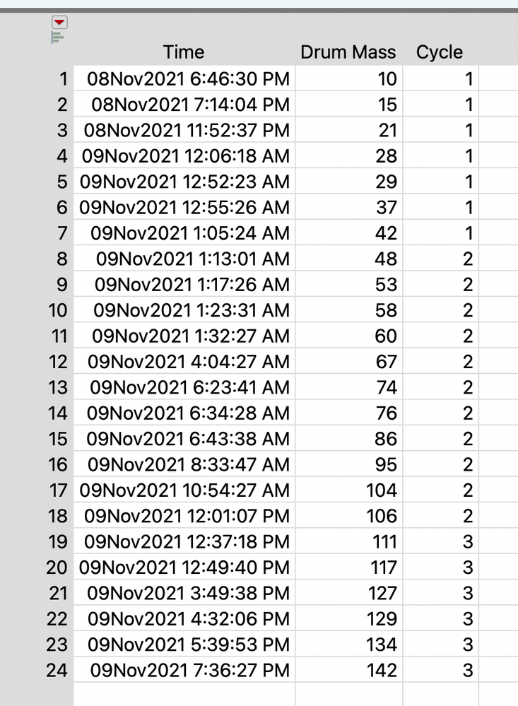

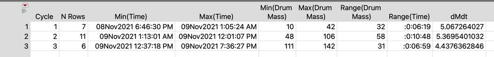

As @jthi mentions, a good way to do this is with the Summary platform, provided you capture the data with some "Group" variable that changes whenever the process is stopped. Here, I've used "Cycle" for this purpose.
For example, suppose we have this data:
We can use the Summary platform, filling out the dialog like so:
Which produces:

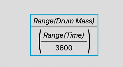

Then, in this new Summary table, create a new column, dMdt, with a formula (the 3600 factor is to convert the base time unit of seconds to hours):
Now we have:
I've attached the first dataset so you can try this out.
Cheers,
