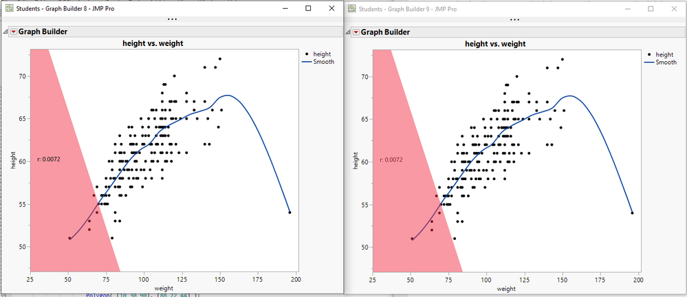

Using the Position element on the Add Graphics Script message one can explicitly set the order a graphic element is going to be displayed on the graph.  Below are 2 Graph Builder plots with the only thing changed is reversing the Add Graphics Script position from 6 to 5 and then to 5 to 6.

fgb << Add Graphics Script(
	6,
	Description( "" ),
	Text Color( "black" );
	Text( right Justified, {45, 60}, "r: 0.0072" );
	5,
	Description( "" ),
	Fill Color( "red" );
	Transparency( .5 );
	Polygon( [10 30 90], [88 22 44] );
gb = Graph Builder(
	Variables( X( :weight ), Y( :height ) ),
	Elements( Points( X, Y, Legend( 6 ) ), Smoother( X, Y, Legend( 7 ) ) ),
	show control panel( 0 )
Report( gb )[axisbox( 1 )] << Min( 25 );
fgb = Report( gb )[framebox( 1 )];
	5,
	Description( "" ),
	8,
	Description( "" ),
	Transparency( .5 );
