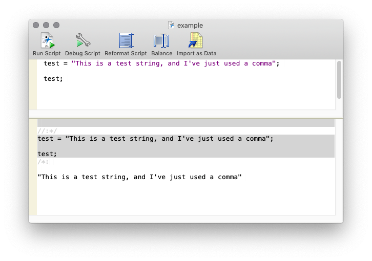

No escape character needed for a comma, you can simply use them inside your quoted string:Screen Shot 2019-06-08 at 12.07.08 PM.png

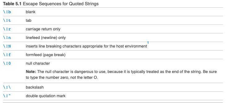

For reference, I've included the jsl escape sequences at the bottom of this post. But, are you encountering a situation where a comma in a string appears to cause some kind of error? I'm sure we can get to the bottom of what's happening if you can elaborate.
