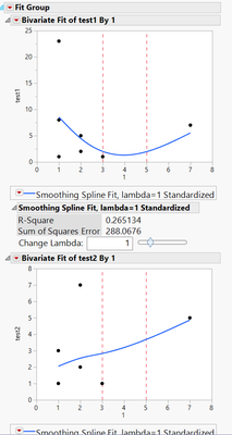

Hello,
so I'm trying to create red lines that will be like in this script
Names Default To Here( 1 );
dt = Current Data Table();
listX = {"1"};
listY = {"test1", "test2", "test3"};
lowLine = 3;
highLine = 5;
bivExpr = Expr(
	Bivariate(
		Y( Eval List( listY ) ),
		X( Eval List( listx ) ),
		Fit Spline( 1, Standardized, {Line Color( "Blue" )} ),
		SendToReport(
			Dispatch(
				"Bivar Plot",
				FrameBox,
				{Add Graphics Script(
					2,
					Description( "Script" ),
					Pen Color( "Red" );
					Line Style( "dashed" );
					X Function( lowLine, x );
					X Function( highLine, x );
				), Grid Line Order( 1 ), Reference Line Order( 3 )}
bivExpr;
and my table DT is like this:
Grouptest1test2test311
BL11111
BL222265
BL233611
POR22222
Value111134
POR57222
Value175173
Value222222
Value081116
result:
my question is how can I create different lines for each graph (for the first one 3-5 for the 2nd one 2-7 and so on dynamically)
thanks!

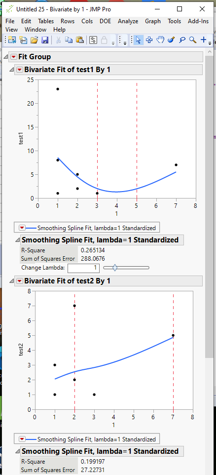

txnelson
Re: JSL create lines on graphs
Using Reference Lines is how I would handle this
listX = {"1"};
lowList = {3, 2, 1};
highList = {5, 7, 9};
lowLine = 3;
highLine = 5;
bivExpr = Expr(
	biv = Bivariate(
	For( i = 1, i <= N Items( listY ), i++,
		Report( biv[i] )[AxisBox( 2 )] << add Ref Line( lowList[i], "Dashed", "Red" );
		Report( biv[i] )[AxisBox( 2 )] << add Ref Line( highList[i], "Dashed", "Red" );
bivExpr;
