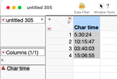

You've not given us quite enough information about the situation but your final question about changing to epoch gives a clue. Yes, the right way to store dates, times, and durations is as a numeric epoch value. If the column is not numeric you can change it to numeric.
Here's an example where it is not numeric. Notice that the column is left justified. That's how character columns are shown.

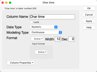

Double-click at the top of the column to get to the Column Info and change the data type to Numeric, Modeling Type to Continuous and the Format to Time-> h:m:s. Check the Input Format. Make sure that matches your current values.

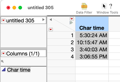

Click Okay and you'll have a numeric column (notice it's right justified).
