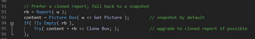

I have a monthly run of capability reports to run, and the internal customer really likes the Capability Explorer from the marketplace - and why not it's really good. My problem is I have 60 individual reports to collate (it makes one per column) - So I wrote (hacked) this JSL which collected selected reports into a journal that I could export to a pdf - it all worked fine (apart from the auto-close windows option - I gave up on that) but fails since I updated to 19.  The error (at least the first error!) is
Expected platform argument in access or evaluation of 'Report' , Bad Argument( w ), Report/*###*/(w)
at line 92 in pathGoesHere\Chooser and PDF export v2.jsl
I'd really appreciate some help or pointers.

Seems like JMP19 has changed what happens when you try to use Report function on New Window: In JMP18 it will return missing value and in JMP19 it will throw an error you are seeing. There are many options you could do, but maybe something like is enough: Add Try() to your line 92
Original:
Modified
rb = Try(Report(w), .);
content = Picture Box(w << Get Picture);
If(!Is Empty(rb),
	Try(content = rb << Clone Box);            // upgrade to cloned report if possible
-Jarmo

Thank you for that - I'm still getting to grips with JSL - Try() is a very new concept for me.
