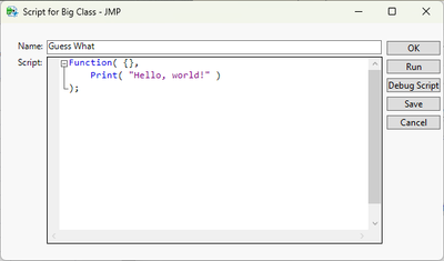

mmarchandFSLR
Level VI
Re: How to use Name Expr of functions inside dt << New Script
Try it this way.
Names Default To Here( 1 );
dt = Data Table( "Big Class" );
toJournal = Function( {},
	Print( "Hello, world!" )
Eval( Eval Expr( dt << New Script( "Guess What", Expr( Name Expr( toJournal() ) ) ) ) );

mmarchandFSLR
Level VI
Try it this way.
