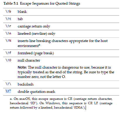

This is handled with Escape Sequences.  Documented in the Scripting Guide, available in the JMP Documentation Library under the Help pull down menu.

my_string = "Hello\!N\!"\!"\!NWorld!\!N";

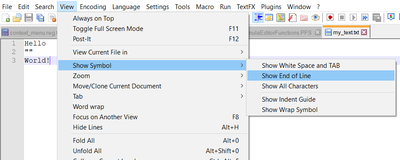

I think the text has been saved correctly with Windows end of line (at least at my System win 10 JMP 15).
I opened the file in Notepad and saw no issue,
but if I check (view-> Show Symbol -> not printable characters -> Show Symbols -> Show end of line) I see the same as you, see screenshot.
Please check your Settings in Notepad, or use different Program ..

I am after this, otherwise a bat file will not be executed just printed out.

Sorry, haven't understood fully your initial question, you're right.
