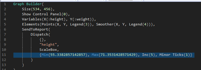

Do your graph scripts have X-axis defined? In graph builder it would be something like this:
This could enforce scaling to your plots
-Jarmo

Thank you, unfortunately because the x-axis is date/time it is constantly fluctuating. Mark replied above and this solution worked. I appreciate the response :)
