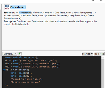

For concatenating data tables use Concatenate() with "Append to first table"
Either perform first data query outside the loop and define that as "main" table or use condition inside the loop to define the main table
If(i == 1, dt = ..);
To capture those ODBC messages you have few options: check for LogCapture() the query and use if statement to check for eeror messages or check for empty() data table.
