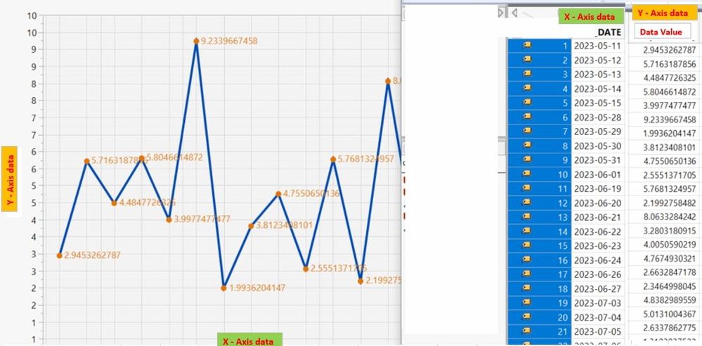

I plotted the Line Chart and manual did turn on Label at Data Source. It works fine. However when I got the JSL code for this the Line plot, and run code JSL, the reading (Data Value for Y-Axis) is gone!  :(  (I just got only line without number of value)
I am not sure if do we have JSL command to turn on the label (Data Value) and also how to set decimal number to some digits (2 or 3 digits) in code level?  Anyone please help on this.
Left side is Line chart that I want JSL plot for me and right side is raw data CSV.

In your case (only single point per X-axis value) you should be able to get JMP to record a script to you and use that
More robust option would be to add second plot to your graph (float bar chart with 0 line width) and label that
Script you can run to test out how it is done and how it looks like in JMP
Names Default To Here(1);
gb = dt << Graph Builder(
	Size(769, 776),
	Variables(X(:name), Y(:weight)),
	Elements(
		Points(X, Y, Legend(3), Summary Statistic("Mean")),
		Line(X, Y, Legend(4)),
		Bar(X, Y, Legend(5), Bar Style("Float"), Label("Label by Value"))
	SendToReport(
		Dispatch({"Line"}, "", OutlineBox, {Close(0)}),
		Dispatch({"Bar"}, "", OutlineBox, {Close(0)}),
		Dispatch(
			"400",
			ScaleBox,
			{Legend Model(5, Properties(0, {Line Width(0)}, Item ID("Mean", 1)))}
		Dispatch(
			"Graph Builder",
			FrameBox,
			{DispatchSeg(BarSeg(1), {Set Width Proportion(-1)})}
-Jarmo
