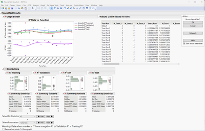

  For a visual, Expr2() generates a window that looks like the following:

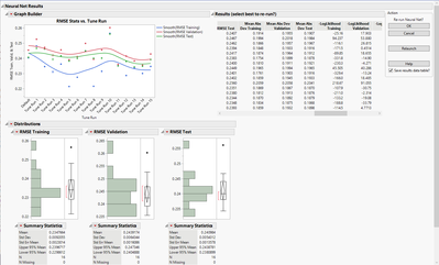

  The first expression, Expr1() is what generates the included Distribution platform below the graph builder. The combo box and button boxes below the distributions allow the user to switch between different fit statistics, such as different R^2, RMSE, Mean Abs Dev, -Logliklihood, etc. My intent is to update both the GB and Distribution accordingly. The GB updates appropriately, but the Distribution does not. When changing the Fit Statistic to RMSE, for example, this is the outcome:

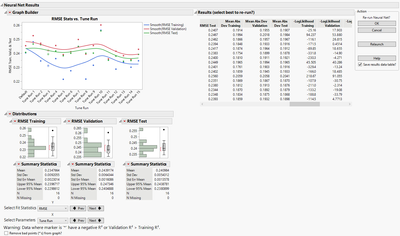

  It does update the Distribution graphs, but it uses their default size setting and not the size setting I've established within Expr1(). it's supposed to look like this where the distribution graphs are the same size as in the first image:
