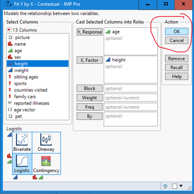

  I was just curious if anyone knew whether or not the color of a button box (when hovering over it) can be customized -- either through File > Preferences, or through JSL with your own code. See the "OK" button box in the image below -- it changes to a light blue color when you hover over it.

I don't think you can really change any coloring on the buttons. If you really need different coloring, you could script your own button (I would use JMP class for something like this) using Mouse box + Text Box and maybe some other display boxes for styling.

  Thanks for your reply and solution. Yeah, I suspected this was not going to be something that was particularly easy to change because it seems to be something built into JMP and not an option that can be changed.
  Anyway, your solution definitely works and does what I was after, but would be very challenging to implement in the code I'm working on. It's good to know that there is a work around in JSL.

The button colors are determined by your Windows operating system colors.  In this case, changing the accent color in Windows Settings would change the button color in JMP.

  Thanks for the additional information. Is this something that could be changed to become a customizable feature in JMP? Just curious.

We usually don't want to go against the operating system button settings, because they provide accessibility functionality like High Contrast for those that have sight impairments.  However, you can always make a request at the JMP Wish List at https://community.jmp.com/t5/JMP-Wish-List/idb-p/jmp-wish-list .
