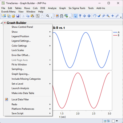

  I'm interested in learning how (if possible) to add the red hot-button menu to your own defined Outline Box. For example, with the Graph Builder platform, there's a red-hot button that allows for things like "Save Script to Data Table" and other options.
  I have other scripts I wrote where I'd like to have this option. The Outline Box comes with the small grey triangle for some options, but it doesn't offer the red hot-button options. For example:

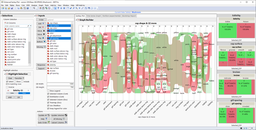

Here is one example I have, the add-in is fairly simple in that sense, that it only contains graph builders (and partition/bootstrap forest).
But trying to save the script that builds that would be a nightmare. There are many hidden things that couldn't be captured by JMP's Get Script or save script to data table (or any of the methods) and the add-in is divided into 10+ different .jsl files. Even if I was able to save the UI to the datatable, it wouldn't work when user re-runs the script due to my tight management of namespaces (UI wouldn't have access to all of the different functions for example). So in this case I only provide user an option to save the column selections and the order (they can save multiple). They can then load different inputs when they have the same table open and re-run the addin.
I could most likely refactor this add-in to work in such a way, that I could save (most of it) to table script or script window, but I would have to rewrite it from the start.

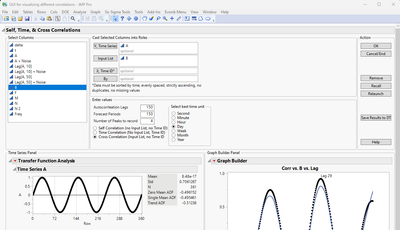

Other add-in (I cannot show pictures of that) I have which queries data based on user inputs, performs some calculations and then displays the results with few graph builders and some extra column switchers/data filters, does save that "platform" /UI/visualization immediately to the data table after the query and calculations have finished. Then I run that table script to show the results to the user. This is fairly simple add-in so I could fairly easily do this with some expressions (initial version I had didn't save the visualization, but it was a request from the users so I did implement it).
