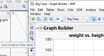

  I'm interested in learning how (if possible) to add the red hot-button menu to your own defined Outline Box. For example, with the Graph Builder platform, there's a red-hot button that allows for things like "Save Script to Data Table" and other options.
  I have other scripts I wrote where I'd like to have this option. The Outline Box comes with the small grey triangle for some options, but it doesn't offer the red hot-button options. For example:

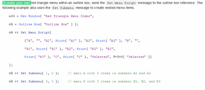

Are you possibly looking for << Set Menu Script? Example from scripting index
Names Default To Here(1);
New Window("Example",
	fontobj = ob = Outline Box("Outline Box",
		V List Box(
			ob2 = Outline Box("Outline Box 2",
				H List Box(
					Text Edit Box("Top Left"),
					Text Edit Box("Top Right")
			ob3 = Outline Box("Outline Box 3",
				H List Box(
					Text Edit Box("Bottom Left"),
					Text Edit Box("Bottom Right")
ob << Set Menu Script(
	{"A", Print("A"), "B", Print("B"), "B1", Print("B1"), "B2",
	Print("B2"), "B3", Print("B3"), "C", Print("C")}
ob << Set Submenu(2, 3);
There is also something regarding this in JMP Help, but it is very very difficult to find due to the horrible search JMP help page has (https://www.jmp.com/support/help/en/17.2/#page/jmp/construct-display-boxes-for-new-windows.shtml#ww8...)

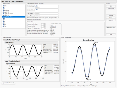

  My customized report window looks something like this:
  I'd like to have the option that the user could select the save script to data table (or scripting window) and it basically saves the script that is used to generate this customized report so that this analysis can be saved to the data table and someone can click the green script arrow next to the script and re-run the analysis without having to re-run the whole add-in.

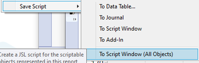

To add Data Filter and Save Script of the Report to Data Table - if you work on a Windows PC, your could consider using the Report Toolbar:
argh ...
