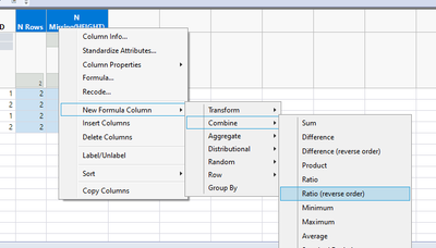

2. Create a summary of the table with N Missing with Height as statistics and SUB_ID and ID as Group
3. Create new Formula by selecting N Rows and N Missing(HEIGHT) columns
4. Change format to Percent from Column Properties and rename columns as needed
Based on these steps you could also fairly easily use JMPs provided functionality to show scripts needed for steps to change this manual process to automated process (small changes should be done to make it more robust).

rverma
Level III
Re: JSL - Find % of missing data
Thank you for the simple and compact solution. It does add an extra column to the original table but that is not an issue for me.
