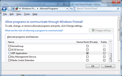

I'll make some guesses:
The JSL debugger is created with a second instance of JMP; the two instances communicate via a socket connection. Usually there is no problem creating a socket between two instance of JMP running on the same machine.  It sounds like the socket connection has timed out.  Do you have an unusual Windows firewall configuration?  Also try ALT-Tab to see if there is a hidden dialog asking a question.  Was it working in an earlier version of JMP?  Perhaps you had to permit JMP previous version in Windows firewall and need to permit the new version?

More info: Re: JSL Debugger Won't Launch, and try technical support if that doesn't work for you; the debugger is very useful.
