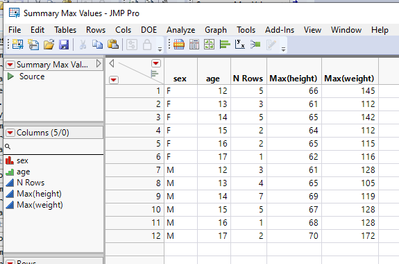

Re: JSL Create new summary table with Max values of variable columns
Hi, Thanks for your code. Here i found i just can get Max of first numeric column, height. Please see attachment. I guess the Max just function to the first value of list. Can you help me know why?
GoodMan
Level III
Under thw latest version JMP, the code works fine. Thanks!
