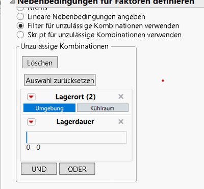

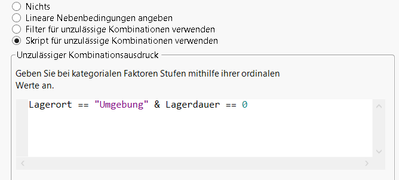

I tried to create a custom design with 5 continous, 2 discrete numeric and 1 categorial factor (all 2 levels). I wanted 4 center points and 3 replicates. This works fine, until I try to define a factor constraint. I have a continues factor "storage period" with the level 0 hours and 48 hours and 2 storage places (categorial), 1 in the production environment, 1 in a controlled climate room. At the storage period 0 hours, the parts have no choice, the have to be stored all in the climate room. If I now try to constrain  the factor storage period 0 with the storage place "climate room" (also cannot be stored in the environment) and make the same design as before, all center points disappear.
Why? I cannot understand why this happens. I cannot see any reason, why with this constraint it would be not possible to set center points.

I understand you. What I am saying is that while you can imagine how it is possible to do it, Custom Design currently cannot do it. So you might have to find a way to manually add such runs. Perhaps fully manually, perhaps getting JMP to enter something as a useful starting point, and so on.
