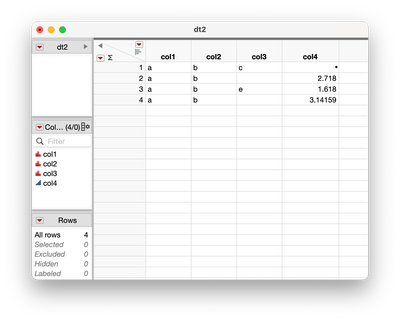

Re: JMP18: python: conversion from pandas to dataTable skips columns with missing values
Using the above p2j( ) and an updated export.csv with the a column of numeric data having a missing value as the first value gives:
% more ~/Downloads/export.csv
"col1","col2","col3","col4"
"a","b","c",
"a","b","",2.718
"a","b","e",1.618
"a","b","",3.14159
