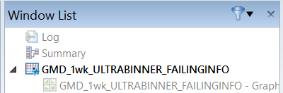

My JMP16 is generating invisible windows, even dialog windows.
When I start a new JMP16 session its starts out ok. But after some time of use, this "invisible mode" just kicks in making that JMP session unusable.
Here is an image capture of the HOME window showing the Summary & Graphbuilder dialog windows as invisible.
To use/populate those windows I have to click on them to bring them to the foreground.

Update:
I re-confirmed that the "invisible mode" was occurring during standard interactive work only.
I also upgraded to JMP v16.2 a few weeks ago and since then I have not observed any issues.
Looks like v16.2 has resolved the issue.
