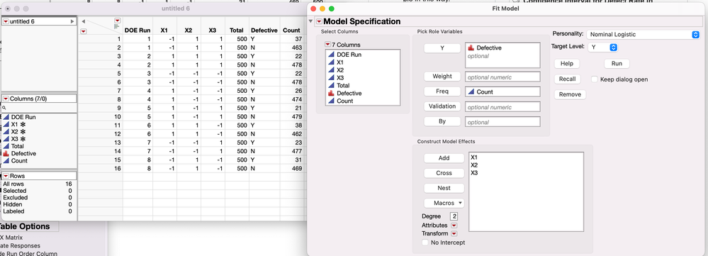

Re: How do I model defect rates from a doe
Mark's suggestion is good, but make sure that you set up the data table properly so that you can do that analysis.  I am going to assume that for each DOE run you have the total number of parts and the number of defects.  You then need to calculate the number "not defective", and arrange the data table with two rows for each DOE run, and the response (Defective) equal to "Y" in one row and "N" in the second row, along with a Count variable to record the number of defective or not defective.  See the screen shot and attached example table.  When you specify the mode., you need to also choose the "Target Level", in this case the indicator for defective, and use the Count variable in the frequency (Freq) role.
