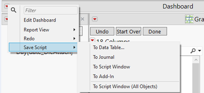

Hi @ValeriaJMP , it's somehow surprising to see
in the context of Journals. On my system, a red triangle menu in a journal looks like this:
Maybe, a colleague used a Journal as an easy way to generate something like a Dashboard?
For Dashboards, there is indeed a similar function:
... and running it from the red triangle menu of the dashboard generates a different result than running it from the red triangle menu of a Graph builder object. Both provide a way to "store all objects" - but just the red triangle menu of the dashboard generates a script with  "new window ..." (like in your case).

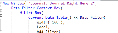

Concerning JMP16 - could you please have a look at
it just contains a script to generate bottom part of the journal with the data filter and the graphbuilder plot - not: all objects.
