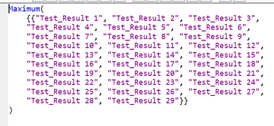

Hi , Tried below command,
Eval(Parse("dt << new column(\!"max_col\!",numeric,formula( Maximum(" || char(use_cols) || ")));"));
were use_cols having the column name,
but not able to find max value,
when checked formula found that " " is appending in MAXIMUM function,
 how to remove the " "

If you want to have formula, here is one slight modification you could do:
Eval(Parse("dt << new column(\!"max_col\!",numeric,formula( Maximum(" || ":" || Concat Items(use_cols, ", :") || ")));"));
-Jarmo

Hi Jthi,
Thanks a lot, you suggestion help to solve the issue
