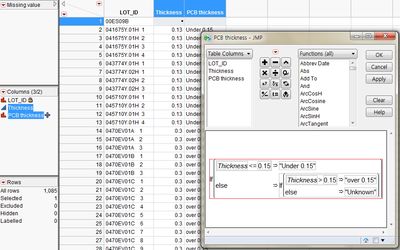

Hi there~ ^^
Could you do me a favor?
Do you have any idea with this? I think this is a simple question, but I dont know yet.
I want to select "Missing continous value" in formula.
I wanna change missing continous values to "Unknow" with character value.

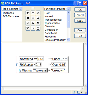

pmroz
Re: JMP formula : Missing value
Use the "IS MISSING()" function:
The JSL code looks like this:
If (:Thickness <= 0.15, "Under 0.15",
    :Thickness > 0.15, "Over 0.15",
    Is Missing( :Thickness ), "Unknown"

pmroz
Steve_Kim
Level IV
Yeah!!!! Thank you so much PMroz.
