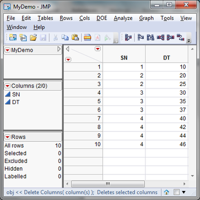

This code shows one way to go about it. I ran it against this data:
mydt = data table("MyDemo");
mydtsummary = Data Table( "MyDemo" ) << Summary(
    Group( :SN ),
    Max( :DT ),
    statistics column name format( "stat of column" )
mydt << Update(
    With( Data Table( mydtsummary) ),
    Match Columns( :SN = :SN ),
    Add Columns from Update table( :Max of DT )
mydt << select where(:DT == :Max of DT) << invert row selection;
mydt << delete rows;
mydt << delete columns("Max of DT");
close(mydtsummary, nosave);

hey mpb,
Awesome!, modified it to suit my data, and it sure works just fine!
thanks a lot

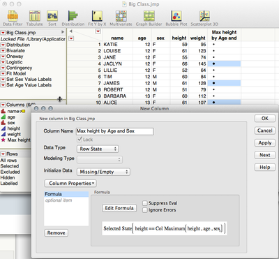

If you're not looking for a scripting solution. You can do this interactively by creating a row state column with a formula.
This uses the Col Maximum function which takes optional arguments for By Variables.
You can also use this function with the Select Where message in a script.
dt = Open( "$SAMPLE_DATA\Big Class.jmp");
dt << select where(
  Height== Col Max(
     Height, Age, Sex
-Jeff
