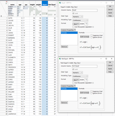

I've tried "Col Sum( :failureType == :failureType[ Row() ] )" but that doesn't work and I don't understand why.  Sometimes ":ColumnName" returns a single value, and other times it returns the entire column's-worth of entries and auto-loops over them.  Is there a way to tell which it will do, perhaps from the Scripting Index?

Sure, open up BigClass.jmp and add a column with this formula:
Col Sum( :height * :weight, :sex )

Even though it looks like it does work, I wouldn't use it (I think it should be fine if it required you to have :failureType as byvar). I would think that it is some sort of unintended behavior (even more than using 1 which shouldn't be allowed either according to JMP support, but let us hope that JMP never breaks that
Make using formula expressions in Set Each Value and using expressions as first argument in Col stat... ).
You could report it to JMP Support and try to see if they can give technical explanation about why it works like it does. You can also try using other comparisons in similar manner

Other option is Col Number()
Col Number(:FailureType, :FailureType)
