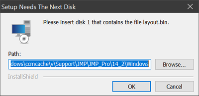

JMP add-in for Excel does not appear
I started to follow the instructions below to un-install/re-install but get stuck when a "Setup Needs Then Next Disk" pop-up appears.

Re: JMP add-in for Excel does not appear
In case you didn't already, I recommend contacting [email protected] to resolve this.
