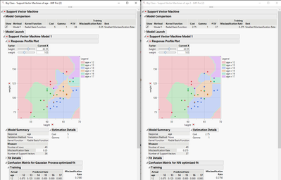

Hi @Mark_Bailey,
  Is there a benefit of using the NN platform for finding the optimal settings for the cost and gamma?
  I do something similar with my data to find optimal hyperparameter settings, but instead of using the NN to try and find the optimal, I use the Gaussian Process platform. I compared the fits from each of the two "optimal" options and the one from the Gaussian Process had a misclassification rate of 0.25 vs 0.275 for the NN method.
Just curious.
Thanks!,
DS
