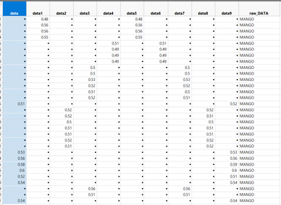

Hi Team,
Currently using JMP15 ,
need help in copying the non empty value from mutiple column to a different columns,
not sure i explained issue correctly below is what i am looking for
Here the column name and count is variable
and each row will have only 2 column with value also
Input:
Expected out put
Column1 and column2 are the output column

Here are a couple of solutions, both of which are modifications of my responses to your previous discussion.
The Loc() function works with missing values, just as it does with zeros.  So the following hard wired JSL works.  The difference is that the Delta is not being produced.  Instead, the first value is being extracted for Column 12 and the second for Column 13

To expand this to the situation where the column names are not known, and the number of columns might be different, the below code will work

building on @txnelson s approach there may be a shorthand script using some built in features. this was achieved by maximum clicking and minimum generalization of the script.
this approach uses the two commands: Combine and Text to column. combine has the advantage that it ignores missing values. in this case it is used as concatenate without missing values.
then, text to columns comes in hand when we want the final data in separate columns.
please do let us know if it works or needs further generalization for your purposes.
ron
