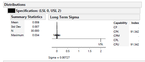

One of our scripts is currently showing a different result when a capability analysis is done.
In JMP 14 we had the following result:

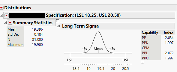

In JMP 15, the exact same expression suddenly shows the PPx values (note - this is from a different analysis, so different limits):

You can turn off the Ppk labelling using the PkK Capability Labeling message.
Either
Names Default To Here( 1 );
dt = Open( "$SAMPLE_DATA/Quality Control/Coating.jmp" );
obj = dt << Distribution( Column( :Weight ) );
obj << PpK Capability Labeling( 0 );
obj << Capability Analysis( LSL( 16 ), USL( 24 ), Target( 20 ) );
or
obj = dt << Distribution( Column( :Weight ),
	PpK Capability Labeling( 0 ),
Blame AAIG for the mess which is modern day capability analysis.
