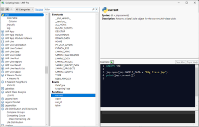

jthi
Re: JMP Python Script editor
Scripting Index and Scripting Guide do have examples for this
import jmp
jmp.open(jmp.SAMPLE_DATA + 'Big Class.jmp')
print(jmp.current())
Scripting Guide > Python > Working with JMP Data Tables > Using Operators to Test JMP Objects (not the best example)
Scripting Guide > Python > Python Syntax Reference > jmp Package Functions
-Jarmo
The import jmp package is the interface layer between the Python scripts and JMP internals.  An entire Python category has been added to the Scripting Index.  This section provides documentation and examples for interacting with JMP from Python.  The Python Integration is a continuing work in progress.  JMP 18 focuses primarily on the minimum necessary set of capabilities.  Package installation, Data Table interaction, transfer of data between JMP and Python.  JMP 19 expands on this with additional data table column support, better interaction with data frames, additional JMP -> Python, Python -> JMP data type support, and other new capabilities...
