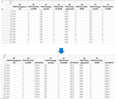

Hello,
If there have a data table like below, how can i using scripts to concat equipmentId and stage_num to new columns with each step?
Thanks.

First loop over your data and create the pairs of interest (if they are always next to each other this might be a bit easier). Then loop over the pairs while creating new columns. If you could provide example of your data it would be easier to provide an example scripts.

Re: Concat columns and adding to each loop
Hi jthi,
Here's the data sample.
One example
Names Default To Here(1);
dt = Open("$DOWNLOADS/example data.jmp");
dt << Clear Select;
// as all columns are interest to use and they are always in pairs
// we can loop over every other column
col_list = dt << Get Column Names("String");
first_col_indices = 1::N Items(col_list)::2;
new_col_list = {};
For Each({first_col_idx}, first_col_indices,
	first_col_name = Column(dt, first_col_idx) << get name;
	new_col_name = Word(1, first_col_name, ":");
	Insert Into(new_col_list, dt << New Column(new_col_name, Character, Nominal, << Set Each Value(
		Column(dt, first_col_idx)[Row()] ||"_"||Column(dt, first_col_idx + 1)[Row()]
For Each({new_col, idx}, new_col_list,
	dt << Move Selected Columns(new_col, After(Column(dt, first_col_indices[idx] + 1 + idx - 1)));
-Jarmo
Hi jthi,
It works on this data sample, but if my data have another columns which is not relate to the columns that i would like to concat, for example only photo and stage column need to concat, but  DRY ETCH column not, like the example data 2 at below, how could I fix your code?
