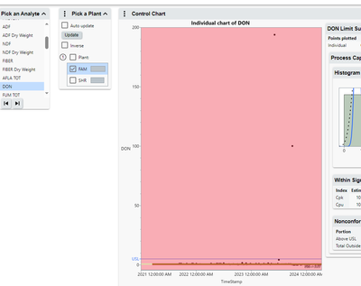

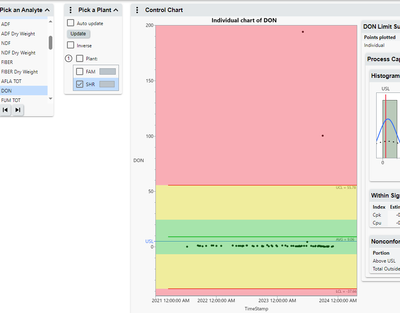

I have a JMP Live control chart with a data filter. When i click the data filter it changes the control chart accordingly. However, when the data refreshes it no longer updates the points in the control chart. It will still update the shaded regions or other aspects of the chart with the data filter selection but not the points themselves.

Select SHR:
Select FAM:
You see in both cases the same data points though the shaded zones and other analysis update. Those 2 high points are from SHR for example but still show up in FAM selection. When i take TimeStamp off the X-axis (would like but not have to have) then the points also change appropriately with the selection. Its odd cause it seemed to work in JMP live until after the data that feeds it was refreshed.
