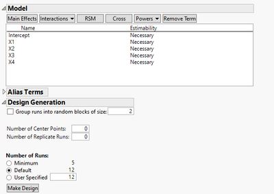

I'm guessing under Custom Design I would need to specify what higher order interactions I would like my model to estimate. For example, below is a screen shot of my design. Based on this, my design would only be able to estimate the main effects, is that correct? If I need higher-order interactions, I'm guessing I would need to specify under Model?
Thank you so much again for your help, Cameron!

@SajithDnot to put too fine a comb to your second post showing the model specification window with only main effects, and a 12 run design...you can estimate select two factor interactions. Reason being you have sufficient degrees of freedom to do so. But as @statman points out...you'll want to insure you spend a few minutes with the Design Evaluation platform to understand the correlation among your parameter estimates. The 12 run design will be most efficient estimating ONLY main effects...but you can estimate two factor interactions.
