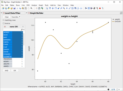

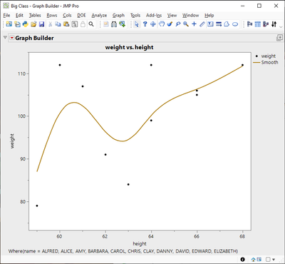

You click on the grey triangle to collapse the outline box (make it hide the filters), then you set the title to empty.
From this
to this
I don't have JMP16 but the script is most likely quite close to this
