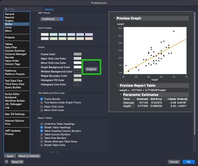

Why doesn't dark mode apply correctly to the Window/Table component? The font turns white, making it difficult to read against the background.
Re: JMP 19 Dark Mode
Hey @Jackie_ - Two possibilities come to mind - one (something I encountered on the Mac) was that I had set something in the styles group of preferences to white or something.  The other option (that I can think of - I'm sure there are probably more) is that there is something about the windows theme that you are using that might be causing a conflict.
To address the first possibility you can go into styles and there is a button that says "original" that should reset everything.
To address the second, you might need to contact tech support ([email protected]) to get some help unraveling what might be going on.
(Edit: you might also have a look at this thread in the community - it looks like a similar problem to yours but in reverse: https://community.jmp.com/t5/Discussions/JMP19-Stuck-in-Dark-Mode/td-p/905568)
Hope that helps!
Thanks @MikeD_Anderson ,
this solution works fine also for me,
But there is arising another issue with that:
When exporting a report or graph in dark mode, JMP uses a predefined gray background. I would prefer a white background for the export, but this seems to conflict with the dark mode settings. Is there a preference or setting I might have overlooked that allows customizing the export background color in dark mode?
this one works well :)
