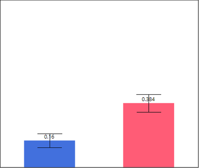

I recently upgraded JMP to version 16.1 (Windows), and I tried to rerun saved GraphBuilder bar plots where Y is a binary categorical variable (0,1), and X is also a categorical variable. In JMP 14.1, these GB scripts would yield full bars with a floor at 0 and a top at the frequency of 1's as shown below.

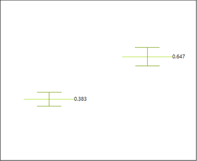

Now, when I try to reproduce these plots in JMP 16.1, I get the following output (note the data is not precisely the same, but the setup is)

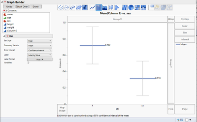

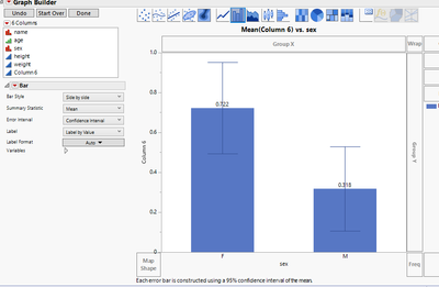

Without seeing the script I can only give a guess: Seems like JMP16 could be using Float bar style instead of Side by Side. Maybe you could open the Control Panel in the "wrong" graph builder and try to see which settings it is using (or determine that directly from script, but it might miss some preferences)
Side by side:
Float:

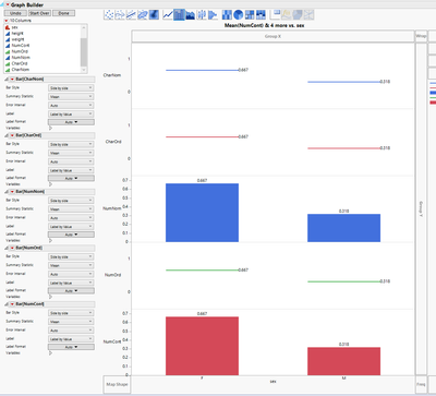

Next thing I'm wondering, is this intended behavior? @XanGregg
Quickly testing seems like Bar Style options do nothing on Numeric Ordinal data or Character data.

Yes, it is intentional. Bars usually don't make sense for categorical data, without a clear baseline or even spacing. Having numeric integer categories is the exception, but hopefully a continuous modeling type is not a burden there.

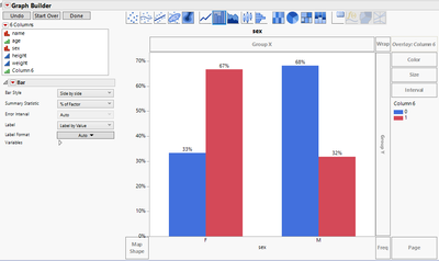

Re-thinking this that makes sense.You would visualize Nominal/ordinal values by using Overlay or other X-grouping:
Would it be possible to disable other selections besides Float if data type isn't continuous to make it more obvious? If Combo Box doesn't allow disabling specific selections, could it be updated to show only the Float option and add "?" button next to Combo Box to explain why it is like that?
