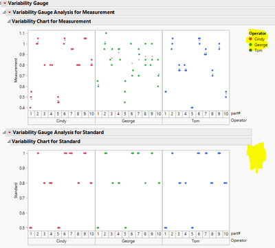

I am trying to add row legends in the VC plots. However, the sendToReport doesn't add legends to all the plots. It only work for the first plot but not for the other VC charts. It used to work just fine in JMP 16.
Any work around?

One option is to use XPath to get references to FrameBoxes.
Names Default To Here(1);
dt = Open("$SAMPLE_DATA/Variability Data/2 Factors Crossed.jmp");
obj = dt << Variability Chart(
	Y(:Measurement, :Standard),
	X(:Operator, :part#)
(Report(obj) << XPath("//FrameBox")) << Row Legend(
	Operator,
	Color(1),
	Color Theme("JMP Default"(1)),
	Marker(0),
	Marker Theme(""),
	Continuous Scale(0),
	Reverse Scale(0),
	Excluded Rows(0)
This example uses ALL frameboxes, but most likely you want to limit the selection in XPath query or use specific indices.
fbs = Report(obj) << XPath("//FrameBox[@helpKey = 'Variability Chart']");
fbs[1::N Items(fbs)::2] << Row Legend(
	Operator,
	Color(1),
	Marker(0),
	Marker Theme(""),
	Reverse Scale(0),
	Excluded Rows(0)
-Jarmo

Re: Issues with JMP17 Variability chart Row Legends
You need to send the legend code to the outline nodes that you are interested in.

Jackie_
Level VI
@tonya_mauldin  I have 200+ columns and brute forcing for each column wouldn't be the best approach.

jthi
	Operator,
	Color(1),
	Marker(0),
	Marker Theme(""),
	Reverse Scale(0),
	Excluded Rows(0)
	Operator,
	Color(1),
	Marker(0),
	Marker Theme(""),
	Reverse Scale(0),
	Excluded Rows(0)
-Jarmo
Jackie_
Level VI
It works. Thank you Jarmo
