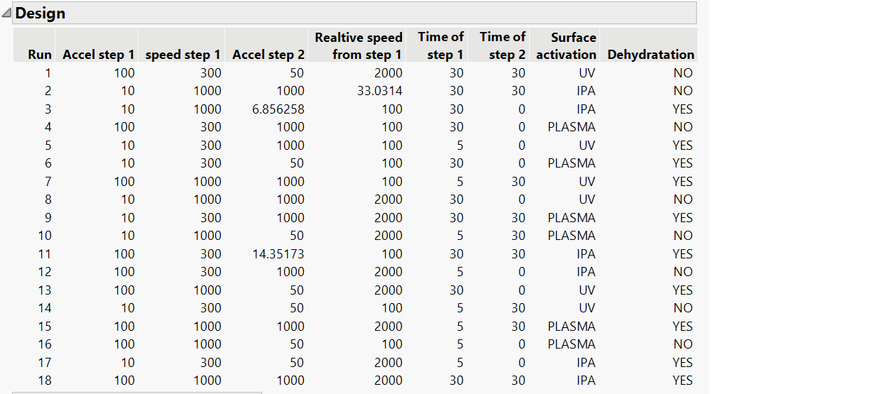

I have two factors for which I want disallowed combination i a Custom DOE.
If the "Accel step 2 = 0 , there can't be any "speed from step 1"
if the Accel step 2 > 0, there cannot be any "speed from step 1" at 0.
I tried to translate like this :
Accel step 2 == 0 & Relative speed from step 1 > 0
| Accel step 2 > 0 &Relative speed from step 1 == 0
The DOE generated is indeed removing these two conditions but also removing other conditions that I need in the DOE, like :
Accel step 2 = 0 and speed from step 1 >0
what is the reason of it and what could I do to solve it ?
