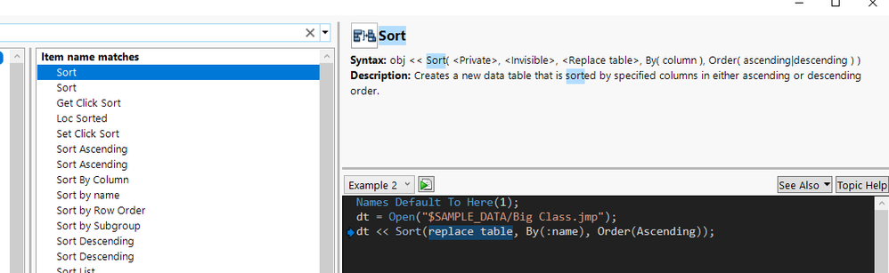

You are missing replace table

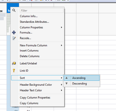

If you do sort in JMP table
You can see what JMP does from enhanced log
// Sort data table
Data Table("Big Class") << Sort(By(:height), Replace Table, Order(Ascending));
