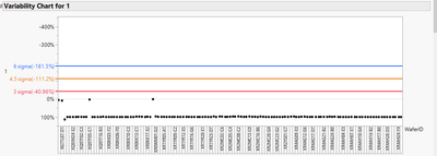

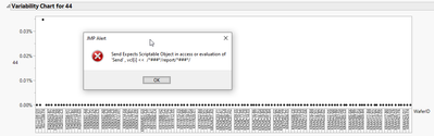

Hi folks,
I just upgraded to JMP 17 and noticed that the add ref line doesn't work on JMP 17 but it works perfectly on JMP 16 . Any suggestions?
JMP 16:
JMP 17:

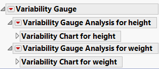

Seems that there was a change from Jmp 16 to Jmp 17:
Variability Chart in Jmp 16:
Variability Chart in Jmp 17:
As @jthi says, just a single report.
So, you have to adjust slightly the index structure.
e.g. replace every  Report(vlc[i]) with  Report( vcl )[BorderBox( i )] .

My first guess is that when Variability chart is created this way, it will only create one reference to the whole analysis so your vcl[i] won't work as there is no list of variability charts.
