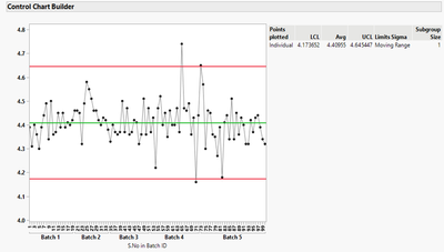

I'm encountering an issue in JMP version 19 that wasn't present in version 18. In the Control Chart Builder, the X-axis label formatting used to display intervals correctly in version 18. However, in version 19, the labels are repeating instead of showing the expected interval format.
I've attached comparison graphs from both versions for your reference to highlight the difference.

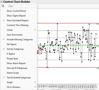

     Got it.
     By clicking "Sort by Subgroup" Option.

Thanks Ben...!
     Got it.
Re: Issue with X-Axis Label Formatting in Control Chart Builder – JMP Version 19
As mentioned above, this behavior is due to the fact that Sort by Subgroup is no longer turned on by default in Control Chart Builder in JMP 19.
This changes the default order of the horizontal axis when there is a subgroup variable.
