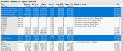

  1. How to evaluate multicollinearity when modeling categorical variables ?
    You can assess multicollinearity of continuous and categorical variables in your model by displaying VIF values in the Parameter Estimates for Original Predictors (right-click on the table, then "Columns" and "VIF"). High VIF values indicate a collinearity issue among the terms in the model. You'll also have singularity information in Singularity Details column if some terms are linearly dependant of each other, as well as the indication "Biased" and/or "Zeroed" before the parameter estimates :
    See more here : Models with Linear Dependencies among Model Terms

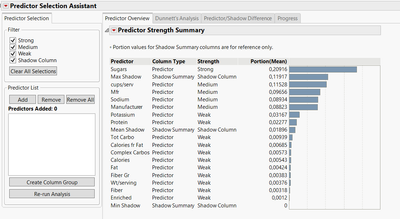

    • You could also try to use the Predictor Selection Assistant add-in that helps selecting variable based on an upgraded version of the Predictor Screening that uses Boruta Feature selection method and Rendom Forest :
