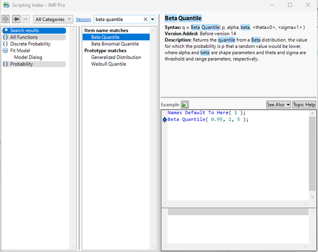

In addition to @MRB3855 response, I will point you to the Scripting Index
     Help=>Scripting Index=<Beta Quantile
It will give you the definition along with an example

Thank you for the screenshot!
