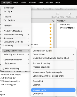

Go to the manage limits platform, Save the spec limits in a Tall Table.

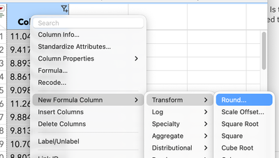

click on the USL column header and make a new column formula, like in the figure below, and round the col of numbers appropriately

Copy the rounded values back into the LSL and USL cols, name the table Spec Limits, and then go back to Manage limits,
Two important steps, Load limits to Table, then Copy to Column properties
