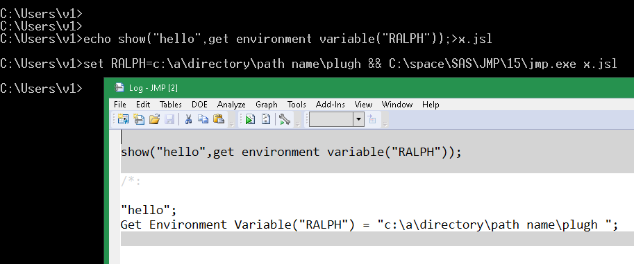

Use an environment variable, and GetEnvironmentVariable("name") in JSL to retrieve it. (You can't use SetEnvironmentVariable(...) to return it, as far as I can tell.) @briancorcoran Environment Variable named RALPHEnvironment Variable named RALPH
JMP gets a copy of the environment when it starts.

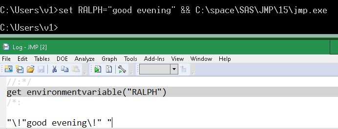

A little more complete example:
Environment variable AND a scriptEnvironment variable AND a script
You could also end the script with a quit(); command if needed.

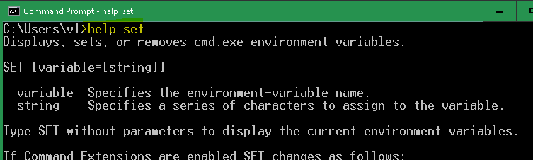

Use the SET command in the CMD window to set environment variablesUse the SET command in the CMD window to set environment variables
