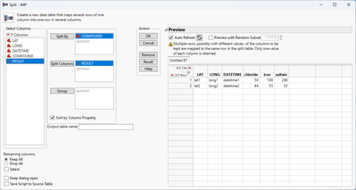

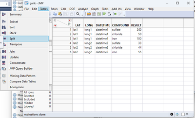

Re: Is there a way to group many rows into one row based on matching values of selected fields?
You just need to "Split" the table:
Hi and thanks for your response!  I am exploring this solution now and will let you know if I have any questions.  Much appreciated!
