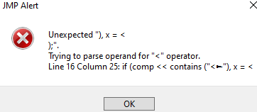

I am trying to reset columns with a character ("<") to numeric and retain the "<" in another column
Hi - I have a table with columns that are made up of lab results (numeric values) that were entered as a text string.  They are text string because some have a "<" in front of the numeric value.  I need to be able to perform numeric calculations on the values so I am trying to remove the "<" symbol and place it in a new column that is named "ORIGCOLNAME_QUALIFIER" (where ORIGCOLNAME is the name of the column from which the "<" symbols were removed).
Unfortunately, the below code is not working.
Names Default To Here( 1 );
dt = Current Data Table();
compList = {};
For( i = 1, i <= N Cols( dt ), i++,
colName = Column( dt, i ) << get name;
// Create the columns
For Each( {comp, i}, compList,
Eval(
Parse(
"dt << New Column( \!"" || compList[i] || "_QUALIFIER" ||
character, nominal,
formula(
x=.;
if (comp << contains ("<"), x = <);
I get the following message:
Any input would be most appreciated.

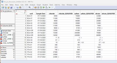

Below is a script that checks for < and for any Post Script values such as "J" or "UJ" etc, and moves the values to a new Qualifier column.  It then converts the column from a character column to a numeric column

That worked perfectly.  And the comment lines are most helpful as they will help me understand each step in the process.  This augments what I can find in the help documentation as I learn how to actually apply these jsl fundamentals to my dataset.  Thank you very much.
